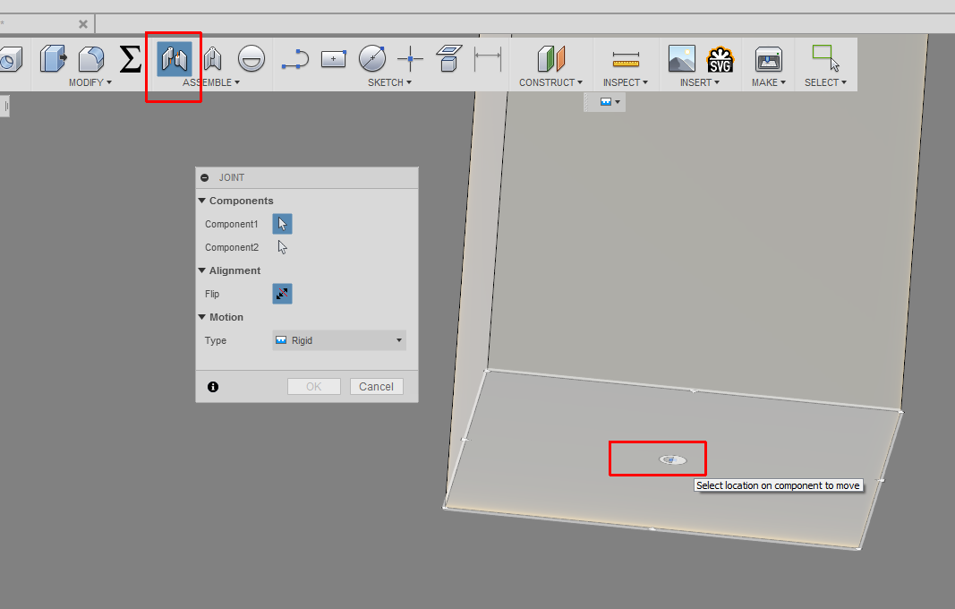

HughesTooling
Here's an idea for point 2. You could use joints, they will only work with components though. First make the origin visible then use Joint Origin and select the document origin, you should have something like this.
Next enter the offset from the origin you want and OK.
Next select join and pick the point on your component you want to use as it's origin.
Then click on the joint you created in the first step.
One advantage to using a joint is it's easy to go back and edit it's position.
