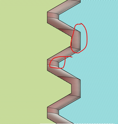

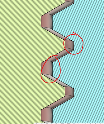

offsetting all 4 faces will cause the peak face to get smaller, and the valley face to get bigger, resulting in a weaker thread (blue is the tapped hole)-
if you offset the peak face , the valley face, and just ONE of the side faces, you will maintain the designed size of the peak and valley faces, resulting in better thread performance-
I'm very pleased to see someone else correcting misleading guidance on this as I have become quite frustrated correcting others on this. I even put together a document ready for next time anyone recommended offsetting all four faces!
