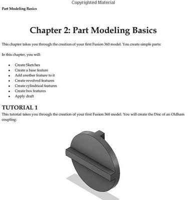

Let's start at the beginning.
File>Export and then Attach you Chapter 1 *.f3d files (all of them) here.
>>Citation<<
From your problem description - I assume you are in Chapter 2.
Attach your current *.f3d file here.
This is a logical approach to problem solving.

I am not sure why you attached the pages, but my reference to page 19 above is for the 2020 edition which is indeed in chapter 2.  Thanks--fs
