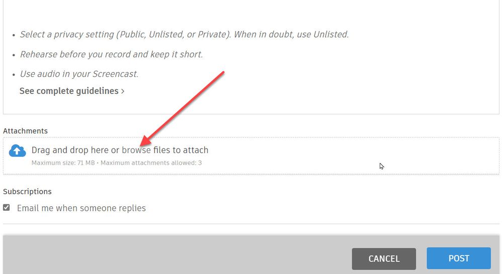

 This is my first design,  I am completely new to fusion 360. I designed a planter for a plant and wanted to add a design to it. A detent greek design coving the entire outside surface. I have YouTubed just about every pattern video I could find. I came close a few times.
 And this is where I get stuck.

jhackney1972
The forum users need your model to help you plus the design graphic.  Please attach them to your post.  If you do not know how to attach your Fusion 360 follow these easy steps. Open the model in Fusion 360, select the File menu, then Export and save to your hard drive. Then use the Attachments section of a forum post to attach it.
