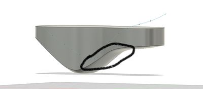

Hello
I have created a mold and on the highlighted spot i want to give a little curve.
The bottom part of the mold already has a curve and i want that curve to continue on the highlighted part of the mold

Hi! I am sorry I don't think I understand what you meant by "curve" in that area. Are you trying to draft the faces (Face Draft) or round the edges (Fillet)?

noob_a1r
concerns are logical if you consider that i am complete amateur user.
The goal is to 3d print that model.
I want to create a pressure mold.
and i want only the highlighted part to have a small fillet

wersy
You mean like this all around?
Or more like this.

noob_a1r
more like the second but on the other side
How you do that??

wersy
For a variable fillet you first need to cut the solid.
Then fillet
You can also use more points to control the fillet the way you want.
Can you show wich part exactly you want to fillet?

noob_a1r
this one

You have been very helpful
Thanks a lot!
Also do you know if its possible the highlighted face to give a curve like the photo i attached???
