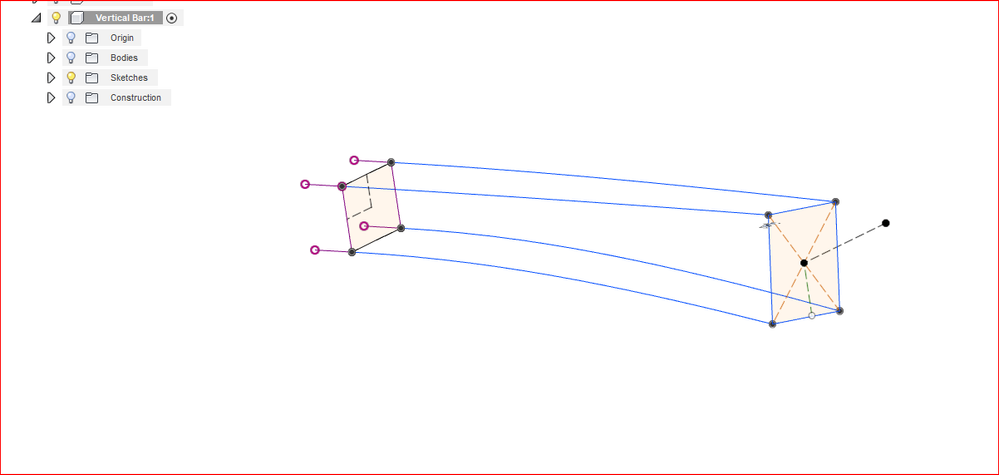

Solid Loft, with (4) 3d tangent, twisted spline curves.  (Right hand end before mirror and combine)
Take the centre line profile, and the end profile is an 8mm square,
Patch loft the centre line profile to the left, dummy body to supply the tangential reference.
Sketch the end profile - 8mm square, aligned to the centre lines in your set out sketches.
(with in my photo it's 10 degrees,) rotate clockwise.
Create a 3d sketch, use Project > Include 3d Geometry, and select the 4 edges of the extruded centre profile body, and the 4 corner vertexes, from the end profile.  Connect a 3d spline to the projected edge, and respective vertex.
Make the centre end of this spline tangent to the projected edge.  Repeat for the other 3 rails.
solid loft the two profiles with 4 rails.  Mirror then Combine.

In the meantime, go back to my wireframe picture,  each rail is a 3d curve, you will need 3d curves turned on, in Preferences, and the sketch pallette.
You need a profile on the centre line, mine was sized from your two sketches.
you need the two profiles in place to make the rails, you can’t twist them as an after manouvre.
Second profile is on an offset plane from the centre, but I used a Plane at Angle from the layout sketch, giving me the length of the bar.  Sketch on this plane, project the two centre line end points into this sketch, and construction Lines to find the profile centre position, sketched the square, removed the vertical / horizontal constrains, and replaced them with perpendicular ones.  Rotate the square (without the construction lines) for me it was 10 degrees.
To make the rails, tangent at the centre line, you need a short extrusion to the left. Patch Extrude the centre line profile.
Create a 3d sketch.  Project > Include 3d Geometry, and select the four corner points in the outside sketch, and the four edges of the Patch body.  Should have total of 8 purple articles, when everything other than this sketch is hidden.
With 2 point Splines, connect the two profiles, making the inside end of the spline tangent to the edge.  Four of those, and the Loft will work.

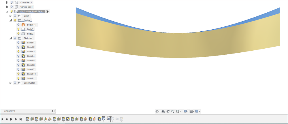

I have attempted to model the cross bar with a twist. I was able to put a twist on the ends of the cross bar
but I couldn't figure out how to add the other curve after I made the 10 degree twist to each end of the bar.
My attempt is under the component name: "Oct 24th CROSS BAR". It looks like you added the twist to the "Vertical
Bar" instead of the "Cross Bar". The Cross Bar has 2 curves that are 90 degrees to each other.
How do I add that other sketched curve to this bar that I sketched on that component. Am I even close to getting this thing right?
Thanks for all your help, Dave. I've included your file with my newly added attempt of which is named "Oct 24th CROSS BAR". This is my biggest challenge so far using Fusion 360.
Gary

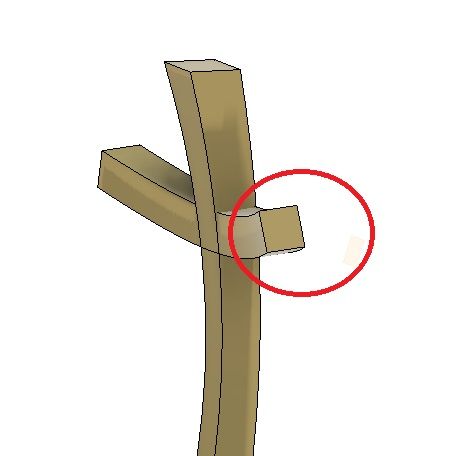

Message 11 of 14
davebYYPCU
I have taken some presumptions from your file,
that being that the top and front sketches do not take the twist into account.
changed some lines to construction in your sketches to clarify the shape
There are usually many ways to get it done, your end plate sketching is not clear what part should be used, so sketched a different way in this file, taking your lead...
I have found the centre point of the twisted face, by developing the construction lines in my Sketch 10.
Add the square profile, twisted 10 degrees.
That done, I have extruded the dummy body, 4 rails in 3d, that are tangent to the dummy body.  Loft and mirror, but not done the combine in case you want to edit that final shape.
I have put my stuff in the timeline before your loft, so you can still see where you were.
Might help.....
