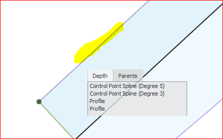

I'm missing something, but what? I just want to fillet an edge, but get an error whatever I try. Can you help please?

Can't say why, but suspect that the separate faces (circled) on the lower side should not be there, considering that sketch 2 spline has no breaks there, (yellow highlight)
Two projected overlapping splines one purple one green, and double profiles is where I would be digging.
That these 2 splines are mirrored and I can't see a Tangent icon for them, may be an indirect factor.
Might help....

try delete faces or change extrusion direction

@lemelman , you need to take a step back and learn proper sketching techniques
1. Fully dimension and constrain at least those sketches that don't contain splines.
2. Some of the spline ends are missing tangent constraints.
3. Don't mirror fit-point splines, as edits to those splines might result in a lack of symmetry. This isn't something many users are aware of and is related to how finite point splines are implemented in Fusion.
You'll find that when using sound sketching techniques, you'll most often not encounter issues like this.

I dug a little deeper, and sketching is tolerable. It could be better, but it isn't the real culprit here.
The real culprit is one of the extrusions that isn't needed:
Message 6 of 9
lemelman
Thank you all for your excellent observations and suggestions. Although I made the ends of the splines inline with their parent lines that was clearly insufficient to ensure tangential. After specifying tangential I was able to create the required fillets. Thank you also for the suggestion of eliminating the extra extrude. I didn't know you could use a curved surface as a target for an extrude.  It's much better than my rather crude attempt.

2. A colinear constraint, or snapping the end of a tangent handle to a line, is equivalent to a tangent constraint.

2. I  can't explain why it worked after specifically adding a tangent constraint - see attached screenshot.
3. Actually, I like your extrusion solution best - it worked and I've learnt something new.
