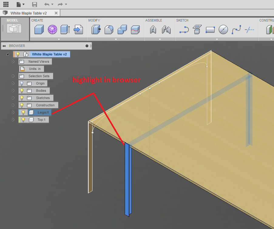

  • As you select component/bodies in the workspace, the corresponding item in the browser will highlight

1. The component will light up if I click on the right item in Browser or the Activity, but it's not working the other way around, which means to find the right item in Activity I have to click on every item until it lights up the part I'm after.

If you're on Window's, I suspect that the highlight in the browser could be graphics related. You may want to check and see if the display drivers have been updated, recently.  To do this:
1. Launch %windir%\system32\msinfo32.exe
2. Browse to Components > Display and check the Driver field for the Date
3. If the driver is older than 6 months, go to the manufacturer's website and update to the latest dirver.
Another thing to look into is what you're actually selecting when you pick something in the graphics workspace. There is a list of selection filters that can help you select components over bodies.
There's also a Select Other feature if you linger on the left click that will enable you to select parent items like a component or component group.
