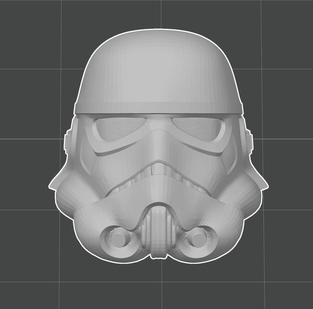

Hi !
I have a Bambu A1 Mini without AMS; I'd like to cut this helmet so I can print the eyes and the respirator at the bottom separately, making them black (and the rest of the helmet white). I'd like to cut to a depth of 2-3 millimeters so I can then have the small pieces to fit into the holes created on the main piece. How can I make this cut by selecting the surface triangles, so as to be as precise as possible?

TrippyLighting
This is a triangulated mesh model and NOT a CAD (BRep) model.
You may be more successful in Autodesk Meshmixer.
Create a facegroup for the eye, for example and then thicken that face group and subtract it from the main mesh.
etfrench
You can use the splitting tools in Bambu Studio.
