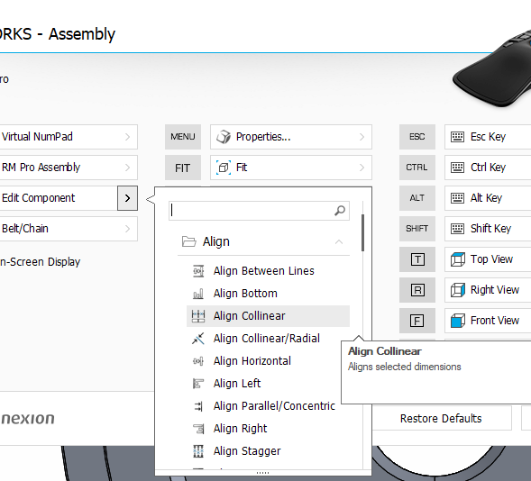

Lonnie.Cady
No, I was refering to setting custom buttons in the 3DConnexion settings.  Instead of listing the commands available for fusion it list the below for fusion.
App Function1
App Function2
App Function3
App Function4
I dont know what the app functions are.  This is for 3dConnexion Space mouse pro windows 7

Lonnie.Cady
I finally had to just take a picture with a camera.  Here is what I am talking about.
