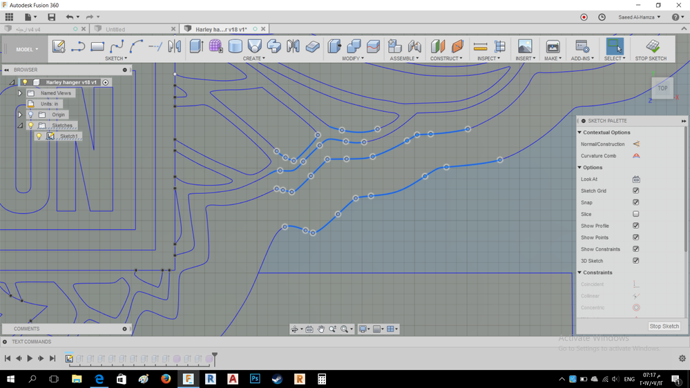

 Thanks for the help.  Here's the file.  What I want to do is (for lack of a better term) pillow outward the "feathers" by about .02" from the areas surrounding them.  In other words, instead of straight-sided extrusions as they are now, have them be a more organic, soft, 3d form.  Does this make sense?  If so, where do I start.  I found the (edit face) command I think it was, but I couldn't get it to do what I want.

fillet is what you mean here by smoothing the extrusion, but it gives error when applying them, and that's because your sketch has so many unnecessary lines :
there are curves that consist of more than one line that should be of just one continuous line, and that is the reason the fillet fails, so I recommend you fix you sketch and then try fillet again

Thanks for the reply, and while I know the lines need to be cleaned up, I don't think fillet is what I'm looking for... rather a smooth curve end to end and side to side. More organic like a feather than machine-edged as a standard fillet.

What I understand from this is that you're seeking something non uniform?
If that was the case then loft or sculpt is what you need

I recommend you before start modeling to fix your sketch, because it might cause you problems down the road no matter what method you'll use
