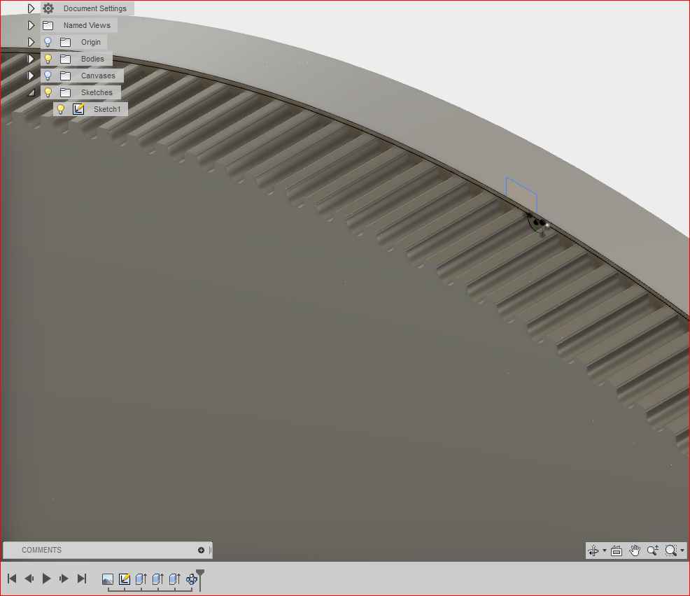

Made a disc, and waited, waited  and waited for fusion to produce the model.
Pattern cut with tangent arcs, took a while but does work.
Might help.....

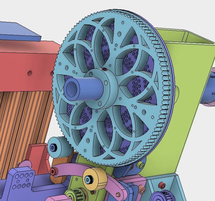

I currently have a 3d printed 7" GT2-3mm pulley on my Rose Engine and it works quite well.  I used a .125" aluminum plate for one flange to add strength and to keep the plastic from warping.  Here's a screenshot of a Fusion 360 model of an early version (The aluminum flange isn't shown and it was GT2-5mm).
 p.s. You may want to consider using G2-3mm as it will be easier to print accurate teeth.  The tops of the teeth in Gt2-2mm are only about .7mm wide which is near the minimum line width for 3d printing.

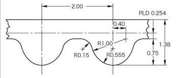

I pinched the tooth profile from the internet, copied the dimensions for one tooth,
Extruded the 4mm ring one side of the sketch,
extruded the base of the belt track, the other side of the sketch,
extrude cut the tooth valley,
then circular pattern that tooth cut, with 240
if you zoom into my photo, about 2 o'clock in the pic, is my sketch.

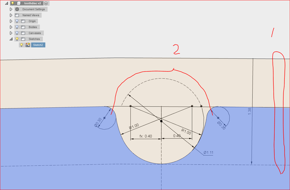

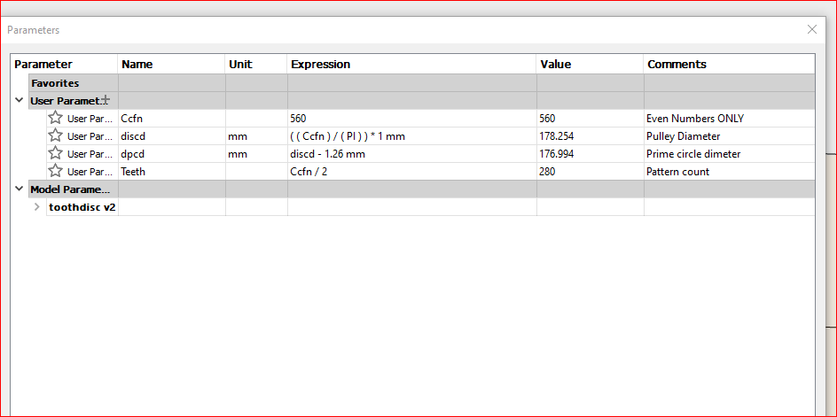

Changed my file to be parametric, I like a challenge, and so far has not broken the file, by changing the parameter for the Circumference, about the limit of my math skills,
other than, Parameter Ccfn = Circumference is found by Diameter * PI.
Used these dimension, most are static, only the three circles and two tangent arcs (indicated in red) are what changes for the differing disc size, the rest of the profile slides up and down the centre line.
Change the length of the circumference, and you get your new disc.
Changes to the disc construction, edges either side can be done, but not with my parameters, this demo is as requested, 6 x 4 mm disk.
File attached,
