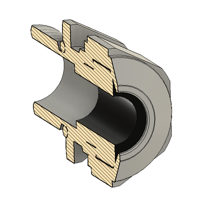

Hello all!
I have a 3D model where I used a section analysis
I would like make a 2D projection with this section analysis but seems impossible.
How can I do it?
Have a nice day!

eng_dpt_2
Hi all!
What I mean is this: I have a 3D model where I apply a section analysis
And when I create the 2D drawing of this but the section analysis isn't take in account, see picture below:
I would like to know if it's possible to keep the section analysis also in the 2D drawing.
Thank you in advance for your answer

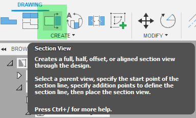

g-andresen
just create same section view in drawing environment
günther

mango.freund
Hello @eng_dpt_2 -- no this is not possible. you have make this intersection in the drawing envirenement

g-andresen
1. create  a section plane (> cut tool) in design mode
2. cut the body (cut body) and hide one part
3. Save design
4. Create view in drawing mode
günther
