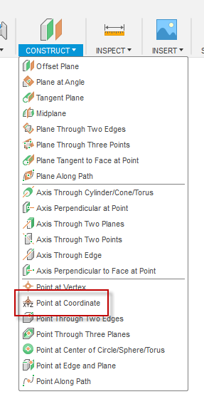

To use it follow the steps below:
  1. Extract the zip to any location on your computer. This will create the PointAtCoord folder.
  2. Run the "Scripts and Add-Ins" command in Fusion.
  3. Click the "Add-Ins" tab in the "Scripts and Add-Ins" dialog.
  4. Click the green "+" next to the top folder in the list of add-ins.
  5. Browse to the location where you unzipped the folder and choose the PointAtCoord folder and click the "Select Folder" button.
  6. Restart Fusion or find PointAtCoord in the list of loaded add-ins, select it, and click the "Run" button.
  7. Now, in the CONSTRUCT panel, you should be the "Point at Coordinate" command, as shown below.
