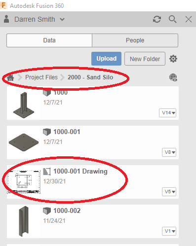

Can anybody help?
Has anybody got a Python script that will allow me (for testing purposes) to open a Fusion 360 "Detail Drawing"?
Please see the attached picture.
I want to specify the folder name, in this case "2000 - Sand Silo" & the drawing number "1000-001 Drawing" in the Python script so, when I run the script, the drawing will automatically open.
Many thanks in advance!!!
Darren

Hey there !
This is indeed possible through the API.
What you need to do is:
- Get the data project of the file you want to open
- Navigate through the folder to that file
- use app.document.open(dataFile)
Using your screenshot I tried to make a snippet but no guarantee it will work as I cannot test it.
# You should probably get the project this way by getting the id of your project
# projects = app.dataProjects
# project = projects.itemById('YourProjectID')
# If the project you're using is the active one this should work
project = app.data.activeProject
rootFolder = project.rootFolder
# You should probably use the id and not the name as I think that will allow you
# to rename the project without breaking the script.
sandSiloFolder = rootFolder.dataFolders.itemByName('2000 - Sand Silo')
# You should use the id here too, I saw that it was in third position in the list
# in your screenshot so i'm trying that out but no promises.
drawingFile = sandSiloFolder.dataFiles.item(2)
app.documents.open(drawingFile)
kandennti
Hi @isocam .
We have created a sample that opens a drawing file(f2d) that is related to the active document (f3d).
