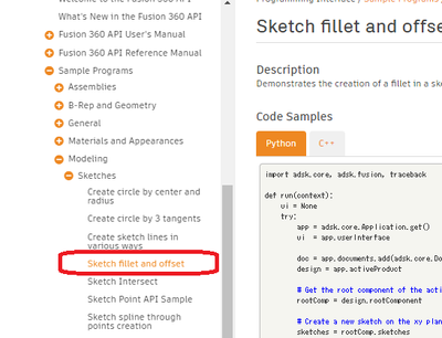

Here is a sample to offset the sketch curve.
https://help.autodesk.com/view/fusion360/ENU/?guid=GUID-e20ca15a-fd06-11e4-aaf7-3417ebd3d5be
