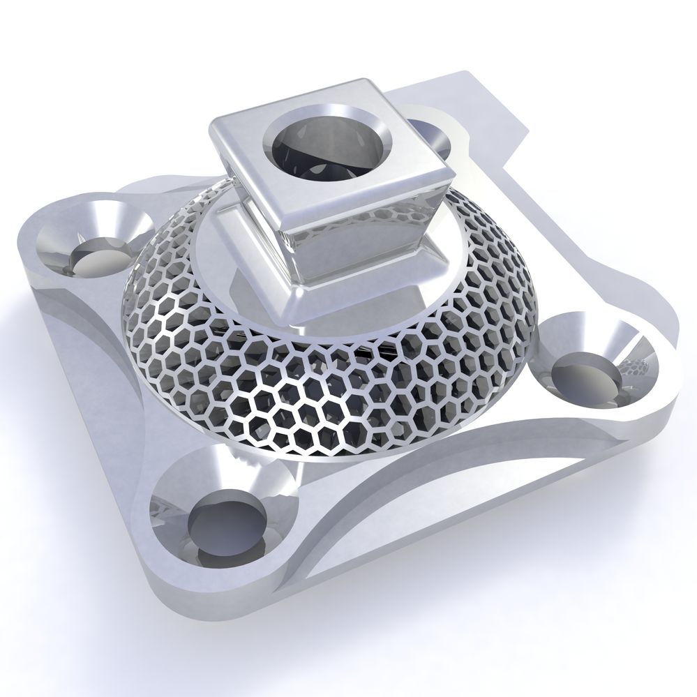

I used Inventor during my Ph.D. and now I want to port and existing piece of software to create patterns on highly curved surfaces automatically. But I can not find a couple of calls used the Inventor API inside of FUSION. One of them is the CalculateFacets() method http://adndevblog.typepad.com/manufacturing/2013/11/getexistingfacets-and-calculatefacets.html
Here some examples of what I can do using the tool on Inventor. Any suggestions on where to look first?
Facade
Hyperboloid
Automated Generation of Repeated Geometric Patterns for Customized Additively Manufactured Personal ...
