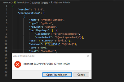

After the update last Saturday to version 2.0.13615 the debugger is not working.
Here I describe 3 situations:
1. If I try to debug a script from Fusion360 (Utilities > Add-Ins > select script > Debug) it opens a new Fusion 360 application, instead of loading VSCode.
Same happen if I try to edit the script from Fusion360.
2. If I try to start the debugging from VsCode I receive the following error message:
As you can see it trying to attach to port #9000 as it is defined both in launch.json and in the preference > General > API > Debugging Port
3. From windows command prompt I looked if the 9000 TCP was listening, but I found the following:
netstat -a -b (running cmd with admin privileges):
TCP 127.0.0.1:10790 Mcortelaser:0 LISTENING [node.exe]
TCP 127.0.0.1:10790 Mcortelaser:61895 ESTABLISHED[node.exe]
TCP 127.0.0.1:61895 Mcortelaser:10790 ESTABLISHED [Fusion360.exe]
which mean the port being used is 10790 instead of 9000.  Last 2 lines show Fusion360 is connected to Node with 10790 TCP port.
If I change to that value in launch.json, the error message in previous section is not shown, but still it couldn't attach to Fusion 360 App and non error messages appear on the debug console.
Anyone is experiencing the same problems?

Message 2 of 10
BrianEkins
It seems to be something specific with your machine. As you can see in the Screencast, I can debug a script using the latest version of Fusion.

KrisKaplan
Fusion runs a node server to serve the data panel, not API script debugging. API script debugging is done by running
debugpy.listen(address=('127.0.0.1', %port%))
in Fusion's Python interpreter. Where %port% is the port defined in the API debugger port application option, which defaults to 9000.
Fusion starts debugpy when you edit or debug a script from the scripts and addins dialog. So the problem appears to be the fact that you cannot edit/debug (it just starts another instance of Fusion). So the question is why does editing a script end up launching Fusion for you?
There has been no recent changes to this area of the code in Fusion. All it does is:
  1. Attempt to determine if VSCode is installed (and prompt to install if it is not).
  2. Run a script in Fusion's python interpreter to setup some environment variables, make sure the script's python interpreter settings are correct, and start debugpy.
  3. Launch the VSCode application with the scripts path.
So the only process launch that should happen here (outside of the VSCode installation step) should be to start VSCode. This is done by finding the VSCode install path, and launching the bin/Code.cmd (on Windows, which it appears you are on). This is normally found in %localappdata%\Programs\Microsoft VS Code\bin\code.cmd. I'm not sure how during this process another instance of Fusion would be getting started. You could possibly try to uninstall VSCode and let Fusion reinstall and set it up again.

Jorge_Jaramillo
Thank you @KrisKaplan for your answer.
My environment is working well now.
I checked it again and I was able to start debugging.
All I did was a reboot yesterday.  Not software upgrades of any kind.
Sorry by my misunderstanding of about node module; I was able to confirm what you said, so it's python who start the debugger on TCP port 9000.
Regarding you last suggestion about dummy.Pool, I'd never used it.
Very estrange this error without a real solution.
