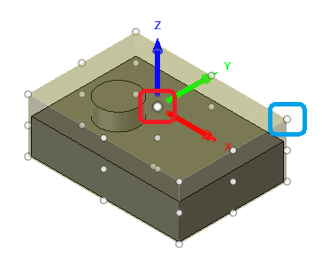

The expression property of the "wcs_origin_boxPoint" parameter is
Red: 'top center'
Blue: 'top 4'
To change it to 'top 4' while it was 'top center', I ran the following code.
        prm = setup.parameters.itemByName('wcs_origin_boxPoint')
        prm.expression = 'top 4'
Unfortunately, I got an error and could not change it.
I guess the change in WCS is not yet supported.
