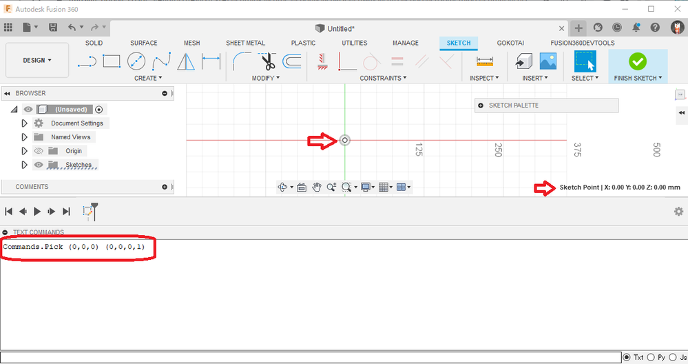

I have tried a few things about "Commands.Pick".
The format of <Point3D> is
(0,0,0)
The format of <BRect> is
(0,0,0,1)
Create a sketch in the XY plane of the root component and execute the following text command
Commands.Pick (0,0,0) (0,0,0,1)
Here is the result.
The origin is selected.
Another thing I found out is that there seems to be an effect of the camera orientation on the screen. Therefore, it seems that we need to manipulate the camera.
This does not mean that you will be able to select brown lines or points.
