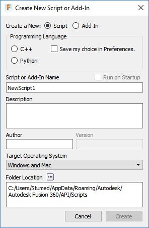

Message 17 of 27
Yves.Poulin
Hello everyone,
I have this exactly the same problem.
I noticed that when I click on button "create" from the Script and add-ins box. I don't have the "Java Script option radion button" like I viewed from other Youtube Video.
I don't know how I can fix it.
It is because that I have a student version?
My setup :
Win10 64bits ver.1079
Fusion 360 ver. 2.0.3800
Active plan : Fusion 360 Ultimate, Student
My "Script" boxMy "Script" box
From YouTube VideoFrom YouTube Video
