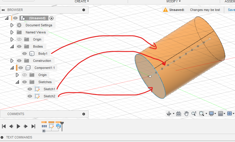

Hi all,
I hope you are doing well. New to fusion modeling, I have been recently facing some challenges with its api. I am writing a script whose goal is to make a sweep based on a circle (as a profile) and a parametric 3D curve (as a path).
To make the curve, I am using a sketchFittedSplines.add() function with a collection of points. Then I find the normal plane at one of its points and sketch a circle on it. I am having issues with the last step: the sweep itself. Almost all the examples - and past issues - I have seen online use design.rootComponent.features.createPath() or similar to create a path for the sweep. However, I am getting an error and I can't really see why (fusion's error messages aren't always very helpful. This is the code that sweeps:

Any help would be very much appreciated.

Hi @ie2230 -San.
I can't judge in detail because I can't try it, but this is one problem area I noticed.
        sweepInput = sweeps.createInput(
                prof,
                path,
                # adsk.core.ValueInput.createByReal(3)
                adsk.fusion.FeatureOperations.NewBodyFeatureOperation

Hello, thank you very much for your response. I was initially confused about whether to use the assigned fusion object or the real value because of what was provided in the documentation. I have done the edit you suggested but the error is unfortunately still present. My code is a bit long, with other issues I wanted to deal with later but here it is:

ie2230
Hi, here is the error I am getting (not very instructive unfortunately):
Concerning models to test the code, I have been using a curve <t,t,t> from t=0 to t=5 with precision 2, units centimeters, profile radius (I think I should've labeled it diameter) 3, t position 0 and same for segment position.
Screenshot 2023-07-17 at 4.41.59 PM.pngScreenshot 2023-07-17 at 4.40.00 PM.png
Jorge_Jaramillo
Hi @ie2230 ,
The problem comes from the fact that you're using path and profile from a component while trying to create the sweep feature in the root component.
There is not reference in the documentation that the curves and profile need to be in the same target component.
I made the following change in you code and it worked:
    def sweep(self, prof):
        # path = self.design.rootComponent.features.createPath(self.spline)
        # sweeps = self.design.rootComponent.features.sweepFeatures
        path = self.component.features.createPath(self.spline)
        sweeps = self.component.features.sweepFeatures
        sweepInput = sweeps.createInput(prof, path, adsk.fusion.FeatureOperations.NewBodyFeatureOperation)#3 for new body 1 to cut
        sweepInput.isSolid = False
        sweeps.add(sweepInput)
Even if the code fail with objects from other components, I was able to create the sweep in the UI to the root component:
I wonder if Autodesk's Fusion 360 team could clarify this issue.
I hope this could allow you to complete your script.
Best regards,
Jorge Jaramillo
ie2230
Thank you very much, it indeed worked! Now that you said it it makes perfect sense: it is naturally not possible to create a path based on a spline that is in a different component of the design. After hours of trying to resolve this by myself you saved me a lot of time. Thank you again!
