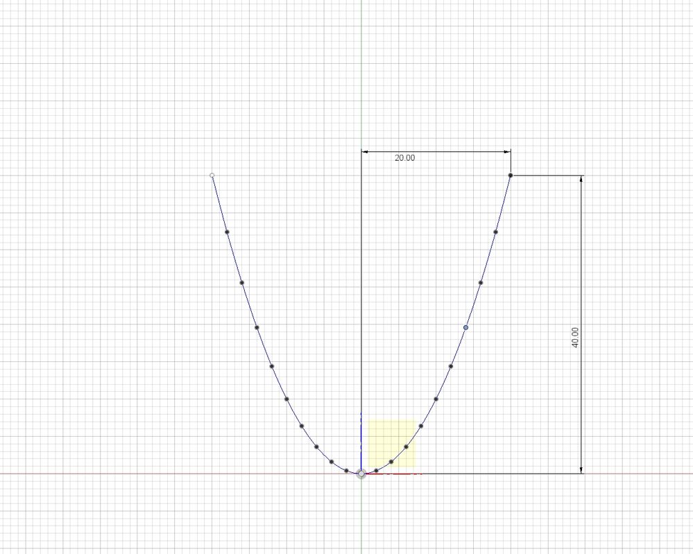

cadTPLWJ
I do not know if it is appropriate to highjack this thread or if I should have made a new thread.
My question is a very small variation on the original question.
I am new to this API and new to Python, however I did quit some LISP work in Autocad a few decades ago.
My question 1: Why is this parabola -20 to 20 in X and 0 to 40 in Z? Would have expected Z to be 0 to 400  I just found out, I am scaling in the wrong place, compute everything in millimeters and scaleonly  when submitting the points.
            pnts.add(adsk.core.Point3D.create(x * scaleFact, -z * scaleFact,0))
My question 2: Why -z?
import adsk.core, adsk.fusion, traceback
import math
def run(context):
    ui = None
    try:
        ui = app.userInterface
        des = app.activeProduct
        root = des.rootComponent
        sketch = root.sketches.add(root.xZConstructionPlane)
        # Default unit is cm, convert to current unit
        scaleFact = des.unitsManager.convert(1, des.unitsManager.defaultLengthUnits, 'cm')
        pnts = adsk.core.ObjectCollection.create()
        startX = -20 * scaleFact
        stopX = 20 * scaleFact
        pts=20
        for pt in range(0, pts+1):
            x = (stopX -startX) * pt / pts + startX
            # Actual function here
            z = x**2
            pnts.add(adsk.core.Point3D.create(x,-z,0))
        sketch.sketchCurves.sketchFittedSplines.add(pnts)
    except:
        if ui:
