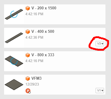

The script below should save the currently open document under new names 3 times. Unfortunately, during operation, the program saves only one document, but v3

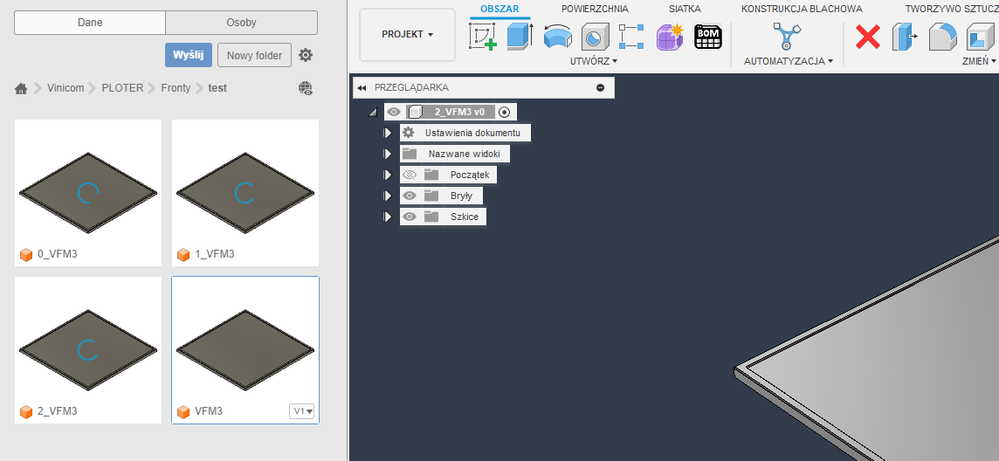

Below are some pictures of the process from start through recording and the end result
How can I force this script to get 3 new correctly saved documents at the end?

For the test, I manually took the F360 offline. The program generated 3 files and saved as expected. Each file has version V1. The program has ended. Up to this point everything works as it should. Then I manually switch to online mode and see spinning circles indicating an attempt to save to Cloud Fusion. It takes a very long time and at the end only one file is saved, but it has version V3. This is a simple script that works on any open document. I suggest running it and see how it works. I thought I had something with Fusion 360, I tried removing it and reinstalling it but it still happens.

The problem still exists and I took the liberty of recording a video in which I show how it works. The program should generate 3 elements of different dimensions. The program generates these 3 elements correctly but when saving only one remains and two disappear.
