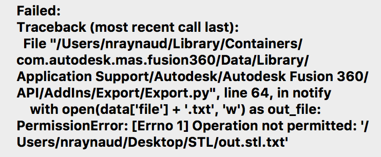

Hi all,
I am trying to create a simple add-in in python, simply to save a body to an STL file. I am a complete noob at the Fusion 360 API, and the learning curve is steep, it always crashed without any meaning error message!
I was about to get things going, when I got this error message when saving the file: "PermissionError: Operation not permitted".
I am suspecting some Mac OS process sandboxing issue, but it has to be noted that I can save an STL file manually from Fusion 360 in the same directory, so it's not a complete interdiction.
here is the message:
here is the work in progress:

It was a Mac OS process sandboxing issue as you guessed. In Fusion 360, you didn't see the issue when you save STL manually was because the permission will be retrieved automatically when users select the folder by dialog. However in your codes, the "file" path was sometimes gotten by a JSON data, not by dialog.
Marshal
Marshal Tu
Fusion Developer
nraynaud
Thanks, is there a way for me to keep the access permission? Some kind of cookie?
marshaltu
You can get the permission programmatically by "Security-scoped bookmarks" described in the following link. Meanwhile you may have to use some Python library like this to call the api from Python. Unfortunately I never try that in Python. Have a good luck.
https://developer.apple.com/documentation/foundation/nsurl/1417051-startaccessingsecurityscopedreso?...
