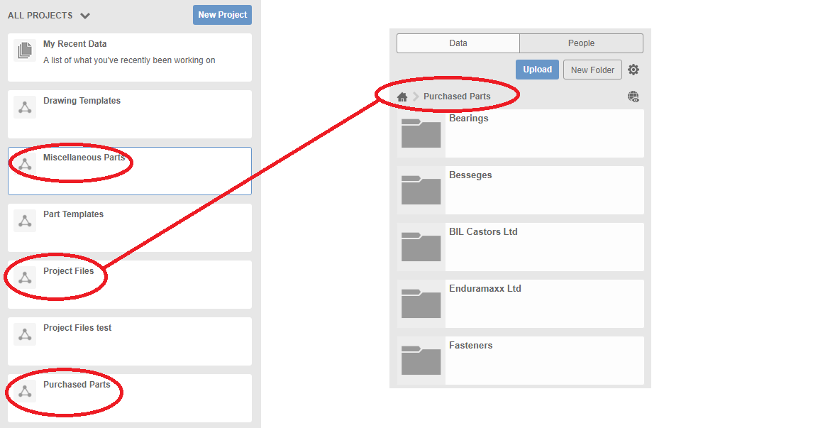

Please see the attached picture and Python script (I have changed the file name extension from "py" to "txt).
All I need is the script file updating so that it will output the folder path of a part that was inserted into an assembly.
For Example:
Say I have an assembly containing several parts. One of these parts has been inserted from the folder called "Purchased Parts" > "Bearings" (Please see the attached picture).
I need to add the folder path to the output, in the above case, this would be "Bearings".

Here's a modified version of your traverseAssembly function that gets the folder name and I believe should also get the quantity. I think there is still some tweaking to do to clean up the output.
def traverseAssembly(occurrences, currentLevel, inputString):
    for i in range(0, occurrences.count):
        occ: adsk.fusion.Occurrence = occurrences.item(i)
        PartNumber = re.split(' v\d+', occ.name)[0]
        PartDescription = occ.component.description
        doc: adsk.core.Document = occ.component.parentDesign.parentDocument
        if doc.dataFile:
            FolderName = doc.dataFile.parentFolder.name
        else:
            FolderName = 'Unsaved'
        PartQuantity = occ.sourceComponent.occurrencesByComponent(occ.component).count
        inputString += SpacePadRight(PartDescription, 77) + SpacePadRight(PartQuantity, 14) + SpacePadRight(FolderName, 41) + SpacePadRight(PartNumber, 53) + '\n'
        if occ.childOccurrences:
            inputString = traverseAssembly(occ.childOccurrences, currentLevel + 1, inputString)
    return inputString
