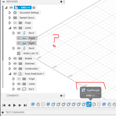

In the browser in my scene, both rigid groups 8&9 are missing, i can find them in the history & the api can see them.
when this file is in its main project it sits like:
(main project) > leg > knee
so there is 2 levels of linked files at this point.
When i run the same short script when the knee is linked inside of  the leg, then the leg linked in side of the main project i hit that runtime error above
Cheers
Kym

I noticed in the image that "Rigid1" and "Rigid2" are Joint rigids, and "RigidGroup9" was created by RigidGroup.
I am sorry, but I am not able to reproduce the state because I do not understand what you mean.
Is it possible for you to publish a simple f3d file that can reproduce the state using that simple script?
