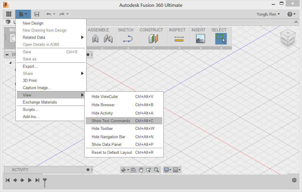

Can you try the following steps to see the problem can be fixed?:
1. delete the folder with name .spyder2-py3 under the user folder, in my case, it is C:\Users\Yongfu\.spyder2-py3
2. show the text command window:
3. Launch Spyder from  the text command window by typing python.ide
If you have two monitors,  please check if spyder window is shown on a different monitor.

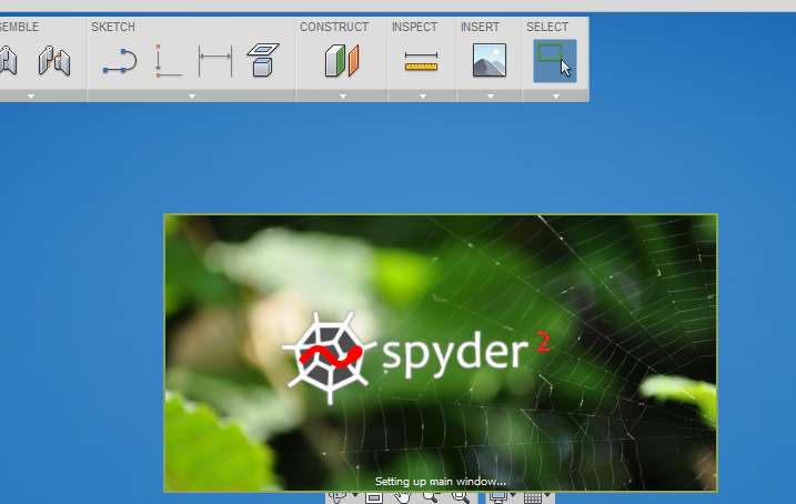

I have the same issue after installing Python(x,y)...
Spyder launches via Fusion's GUI, but doesn't get past the "Setting up main window..." splash screen below, then disappears.
My environment variables look OK to me, no double entries, so the above solution doesn't work for me. I can however launch Fusion's Spyder via the Text Command window...
I can also launch Spyder that shipped with Python(x,y).
I deleted the .spyder2-py3 directory that Fusion put there, then tried editing scripts again via F360, still gets stuck at "Setting up main window..." splash screen, then disappears. Deleted all the .spyder2 directories, tried again, no luck. Also restarted Fusion, no change.
My platform: Win 8.1, 64-bit. User account without admin privlages (I have a separate Admin account).

I can reproduce the problem by installing Python(x,y). At least in my test, the issue was caused by addtional paths added to the enviroment varible PATH. I could resolve the issue by removing C:\Python27\Scripts in the PATH enviroment varible setting. "C:\Python27\Scripts" contains another set of Spyder scripts that cause the startup failure. Please see the screen dump below on How to update PATH enviroment varible.
Please let me know if the above temporarily solution works.

Hello Yongfu;
Removing C:\Python27\Scripts from the Path env variable worked for me, thanks. I don't know if it will break things on Python(x,y)'s side, I may only discsover that at a later stage, but for now it's OK.
