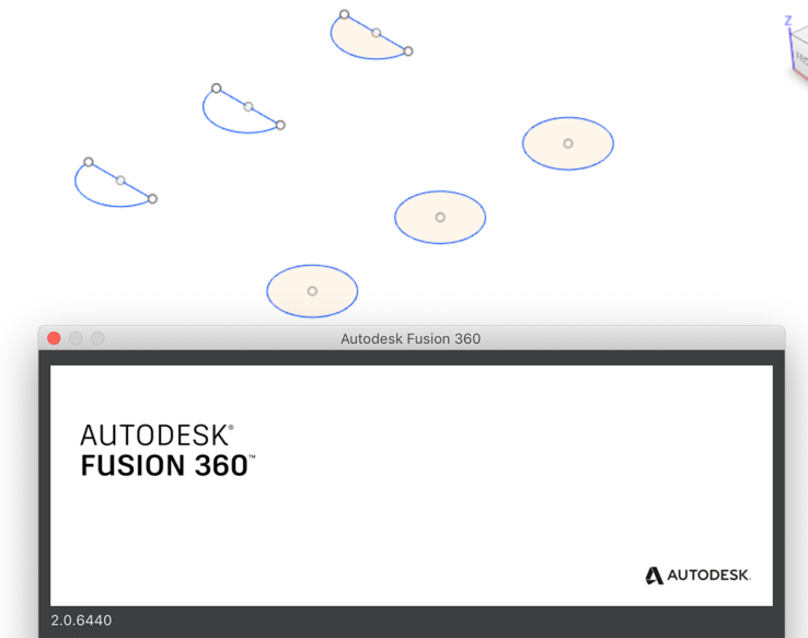

Whenever I add a new closed loop to a 3D sketch, it creates a profile(as expected), but it also deletes the previous profile. Is this an error!?
Here I add three closed loops using arcs+lines and three circles. As can be seen on screenshot, it is only the very last one of the arc+line that creates a profile, but there is no problem with the circles. My further experiments shows, that there are no problems in the sketch plane.

This issue is fixed and will be available in coming Fusion releases. Here is the ticket number FUS-52057. Thanks for posting it.

Thank you. Unfortunately the fix is not yet included. I am hoping for the next one 🙂
goyals
Yes it is going to be part of next release. Thanks for your patience.

I think there has been two or three releases(updates of my Fusion 360), and the problem persists. Is it just taking longer than expected to migrate fixes to releases? -or maybe I do not understand what a 'release' is?
goyals
Fusion release cycle is different from traditional CAD software. Some times If we discovered some serious issue which requires a hot fix then we put more updates after a release which mainly contains fix for some serious issue. That is what happened after September release and We ended up providing 3 updates.  The fix for this problem will come as part of October release which is coming very soon. Thank you for your patience.

After the bug fix, I have now encounter a new problem - please see this:
