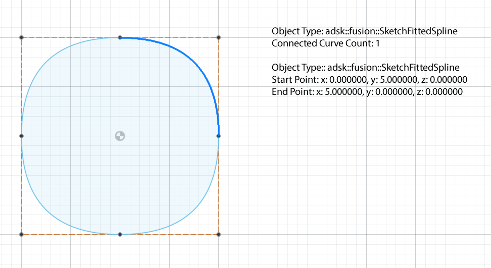

Problem of Control Point Splines in using Sketch.findConnectedCurves
nnikbin

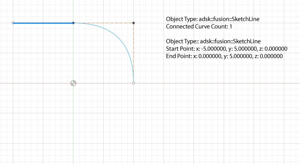

We already know that according to @marshaltu , Unfortunately the tangent handle line is treated as a real curve in Fusion 360.
It is not a big problem because we can hide them by getting them using SketchFittedSpline.getTangentHandle method, then deleting them using SketchFittedSpline.deleteMe method. We can also make them visible again using SketchFittedSpline.activateTangentHandle method.
But I think the problem with Control Point Splines is bigger. I was not able to find any API to hide control point handles and they make problems in using Sketch.findConnectedCurves method.
For example, for the following samples I used findConnectedCurves method to find the connected curves of each selected curve and printed the Object Type and Connected Curves Count for the selected curve and Object Type, Start Point and End Point of each curve in the returend ObjectCollection.
As you can see the control point handles make the output of findConnectedCurves method almost useless.

MichaelT_123
Hi Mr  NNikbin,
Yes, there is the conundrum here, as the fixedSpline handles are required to distinguish it from other curves, contributing to the outcome of findConnectedCurves method.
How to solve it?
I have not tried it but consider checking isDeletable attribute in the connectedCurvesCollection removing respective curves from it.
Perhaps TF360 might recognize it as the thing worthy to implement internally.

Thank you @MichaelT_123  for your reply,
The main problem is:
If there is a Control Point Spline in a sequence of connected curves, findConnectedCurves return a wrong list. For example in my 2nd and 3rd examples it returns just one curve instead of 2 or 4, because the algorithm for finding connected curves riches a branch (a real curve and a handle) and stops.

Thank you @MichaelT_123  for your interesting suggestion on using createPath. I tried it and unfortunately it has the same problem as findConnectedCurves.
