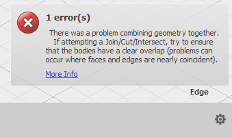

I am wondering - is it possible to use popup windows to display some information about my script. Or that window in right bottom corner reserved only for system messages?
Or may be someone could offer other variants to show info messages to user (but not ui.messageBox

It is possible to use the error message functionality that you pointed out but it's currently limited to only being used within a command.  In the execute event a CommandEventArgs object is passed in and it has the executeFailed and executeFailedMessage properties.  The first indicates that the execute failed for some reason and the second provides the message that will be displayed in the error box.
Something that's coming soon is also the ability to write to the TEXT COMMANDS window. That can be a convenient place to display information.  That's probably mostly useful for debugging but could also be useful in some cases for displaying information for the user.
