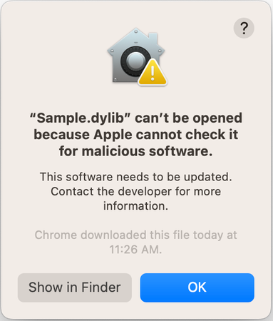

Without making any changes to your code, I copied your .bundle folder to my ApplicationPlugins folder and then ran the "Scripts and Add-Ins" command and looked on the Add-Ins tab and it is there, so Fusion is finding it.
However, when I try to run it, I get the error below.
I found this that was able to let me override the security and load it and it runs as expected.
https://support.apple.com/guide/mac-help/apple-cant-check-app-for-malicious-software-mchleab3a043/ma...

Hi @BrianEkins,
As you mentioned in the above message that you were getting the issue of "Plugin can't be opened because Apple cannot check it for malicious software".
We are trying to resolve this but we are having some issue.
The code we have written is in the C++ and are using XCode IDE for coding.
We have used the library template in the XCode to build the code because if we create a New Add-in directly from the Fusion360 it also uses the library template.
But now in library template we are not able to signing the bundle.
Can you help on this? Any documentation would be helpful.
