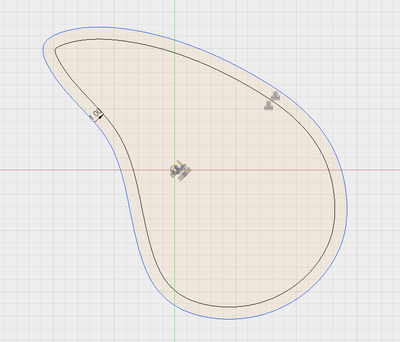

I found some behavior that I don’t understand regarding the offset of a set of closed loops.
I have two closed loops almost similar, generated by two dxf file and slightly rotated by an angle.
I used the same function to generate the offset inward for the two closed loops.
This is the code:

I find the same behavior using the UI. So I recreate the issue using the interface.
If I create the offset for the first loop all is ok. It generates a closed loop inward:
It creates only one closed spline .
But if I do the same operation for the second loop it give me two splines (this could be right) but it does not close the loop:
Someone can help me ?

It seems that the curves in the second place aren't connected.  They may or may not geometrically touch (the endpoints are at the same coordinate) but I don't think they share the same sketch point.  The white point that I can see in your image indicates that there is an free end point.  Because they're not connected, the offset doesn't attempt to keep that corner closed.

Hi Brian, thanks for the immediate reply. But there is something that I don’t understand in your answer.
When I use the offset operation I start from a closed loop that has no point on it.
It is closed, in fact I can select it and point out the relative profile.
When I use the offset operation on it,  a point (the white one) springs up on the original spline and the created curve (inward offset curve) is open and consists of two spline.
I can see the gap in the offset curve if I use the max zoom I can use in the UI.
With this zoom there is no gap in the original curve.
In addition I can remove the white point on the original curve, selecting it and deleting it.

I thank you for the reply. Maybe I’ve found the problem. It is connected to the copy operation from one sketch to another.
I attach three dxf file: 22.dxf, 21.dxf and 2.dxf
The first have no problem. The second and third have it.
These are the steps I followed to reproduce the issue.
·         Insert a dxf file choosing the XY plane (this create a closed curve – CURVE_0 and a new sketch – (it has the name of the dxf file)
·         Create a construction plane with offset 22.5 mm from the XY plane
·         Create a sketch (SKETCH1) over the new plane
·         Select the CURVE_0 and copy it on the new sketch (SKETCH1). I call it CURVE_1. I used CTRL-C – CTRL-V to make the copy.
·         Use the Offset operation selecting the CURVE_1 and choosing an offset of -1.0 mm
If I use the 22.dxf curve there is no problem. If I use the 21.dxf or the 2.dxf curve the problem arises. If I use the offset operation on the same sketch there is no problem at all.
Maybe the problem is connected to the dxf file ? I have no competence about the dxf format so reading the file with an editor I cannot understand if there are problems.
When I do the copy operation a white point arises in every dxf file. I don’t know why !
I hope that the description is clear.

I Brian, I had the doubt that the problem can be connected to the DXF files that I sent you so I decided to recreate the two file 2.dxf and 21.dxf. I drew again the closed splines and I made again the tests. The result is that the problem has gone away.
Talking with you has been helpful and it has clarified the problem.
