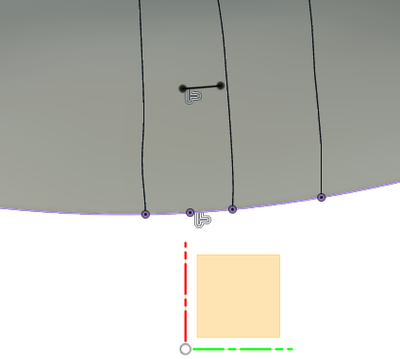

I am trying to offset a sketch of a projected spline

This is now working, however the projected curve that I am trying to offset is made up of multiple connected spline segments. With this code only one segment of the spline is being offset.  I'm not sure how to collect all of the projected curves to offset them all.
