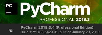

Currently trying to get this plugin to work but I'm having an issue with the Python debugger timing out and failing to connect, any idea of how I can fix this?
Message 26 of 84
JesusFreke
I'm not sure what might cause that. The only thing that comes to mind is an overzealous firewall or something. The connection should be with local ports though, so I would be a little surprised if a firewall would be blocking that.
Message 27 of 84
JesusFreke
I just updated to the lastest version of Fusion and tried the plugin, just to make sure there wasn't something in the new version that broke things. It worked fine for me.
Also, just to double-check, you're using the latest version of the plugin? 0.5.5?
And which version of pycharm?
Message 28 of 84
I've run plenty of online stuff through PyCharm before so I doubt its a firewall issue, uninstalled and re-installed the plugin just to make sure it's definitely 0.5.5 and I'm still getting the same issue.
Running PyCharm version 2018.3.4, Python version 3.7 for the venv.
Message 29 of 84
JesusFreke
I just tried it with 2018.3.5 and it's working fine for me.

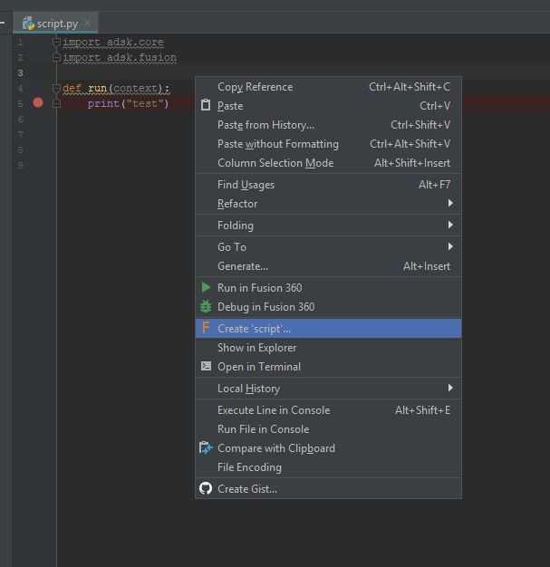

Tell me plz, is it possible to run programm via PyCharm by pressing green "play button" like in Spyder, when it automatically starts in Fusion.
And another question about python console, how to set up in in PyCharm for message reciaving like in Spyder?
Message 38 of 84
JesusFreke
Yes, once you create a run configuration, you can run or debug the script from the toolbar.
The easiest way to create a run configuration is via the context menu.
There's currently no way to capture the output when you "run" the script, but it does appear in the console when you debug the script.
Because of this, 99% I use "debug" instead of "run".
