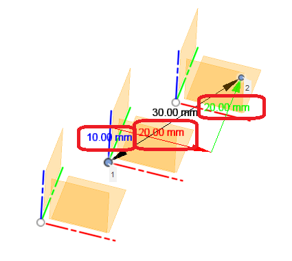

kandennti
@rusty.bird .
I am getting confused too, so I did a test to confirm.
This was tested based on ver 2.0.15509.
Create a component (level2) within the root component (level1) and then a component (level3).
Each component is created with XYZ+10.0.
Activate the level3 component, create a sketch on the XY plane, and draw a square.
Constrain only the lower left point by 10 mm in the XY direction.
Create the body by extrusion.
Create construction points at the vertices near the origin.
"Sketch point", "body vertex", and "construction point" all remain in the same position in the level3 component.
(The f3d file of this data is attached.)
Using this data, the following script is executed.
The text command is designed to output the coordinate values of the selected points.
We expect the output to be the coordinate values (3.0,3.0,2.0) from the origin of level1.

The reason why selectEntity is used to select an element is because the selected element will be a proxy.
Here is the actual output.
 adsk::fusion::SketchPoint -> (3.0, 3.0, 2.0)
 adsk::fusion::BRepVertex -> (3.0, 3.0, 2.0)
 adsk::fusion::ConstructionPoint -> (2.0, 2.0, 1.0)
SketchPoint(worldGeometry) and BRepVertex are as expected, but only the ConstructionPoint is different.
The construction point coordinates are from the origin of the component one level above (level2).
I cannot determine if this is a bug or a specification. Unfortunately, the origin of each component is also greatly affected by the construction point.
I am sure this is a very confusing situation.
