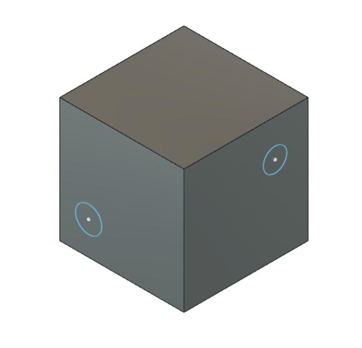

I have some code where the user selects a face for the sketch plane, and a point is created where the user selected that face.
 if changed_input.id == 'face':
            selection_input = inputs.itemById('face')
            selection = selection_input.selection(0)
            xyPlane = selection.entity
            clickPnt :adsk.core.Point3D = selection.point
            clickPoint = clickPnt
            _inputSelectNominalDiam.isVisible = True
            strResult2 = ' '
What I want to do is move the coordinate system to the point that the user selected (clickPoint) so I can create the sketches from that point. Centers of the circles shown below (could be anywhere on face)
It could be any face of the body/component.
