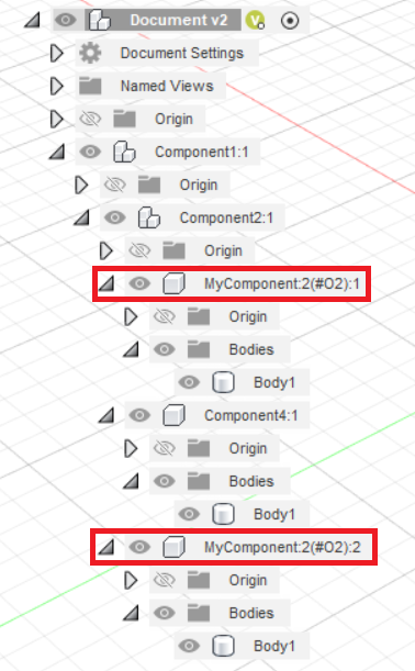

Is there any API to rename Occurrence object?
varun_nct
Member function "name" of Occurrence class returns the name of the occurrence. There is no setter method for name.
Observed that Component class has member function "name" to set name. So, we used this method on Component of an Occurrence to rename Occurrence. But observed that it renames all it's Occurrences present in document and not the one we selected from Component List on LHS of Fusion 360 View window.
Observed same behaviour when used "name" method on nativeObject of an Occurrence then.
For assemblyContext occurrence the "name" method sets name of the Component in which Occurrence is present.
We expect setter method of "name" in Occurrence class to rename a selected Occurrence only and not all Occurrence or it's Component.

Hi @varun_nct .
I think Occurrence.name has the following specification.
<Component.name> : <instance index>
Therefore, I think it is read-only.
BrianEkins
@kandennti is correct. Fusion does not support the naming of occurrences and the name is derived from the component the occurrence references.
