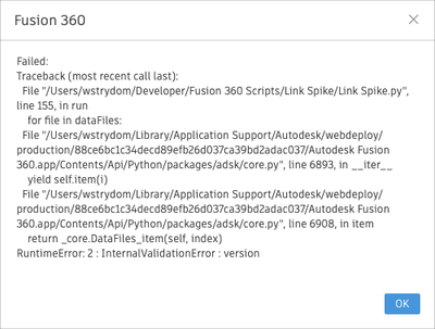

At the TODO statement, I added the following
        # TODO Import components
        dataFiles = project.rootFolder.dataFiles
        for file in dataFiles:
            if file.name == 'Component 1' or file.name == 'Breadboard 1':
                occs = root.occurrences
                occs.addByInsert(file, adsk.core.Matrix3D.create(), True)
which gave me this error
I can't find a good example of how to insert a component from a file. I suspect that both "Breadboard 1" and "Component 1" may not be available to be inserted into "Config 1".
I found that I could just run three different scripts and wait in-between, but that isn't ideal when there are tens or hundreds of them. I'd rather run the script and spend time with our daughter, or attend to other important matters.

kandennti
Hi @bloudraak .
Fusion360 itself has not been updated yet, but the documentation What's New has been updated.
https://help.autodesk.com/view/fusion360/ENU/?guid=GUID-36B1FFB5-5291-4532-8F11-90E912769B34
"2.Knowing When a DataFile is Completely Saved"
will probably solve this, but I won't know until I try it.
bloudraak
A solution was posted on how to wait for the file upload to complete https://forums.autodesk.com/t5/fusion-360-api-and-scripts/runtime-error-trying-to-determine-whether-...
Software Engineer
https://wernerstrydom.com
