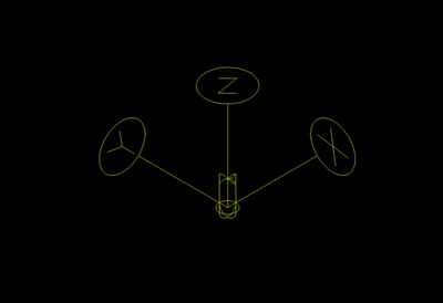

Hi autodesk, There is no issue in powermill while importing, but in fusion the curve is not showned in graphics window. i have attached the powermill image for reference. Is it possible to import the curve model in fusion?

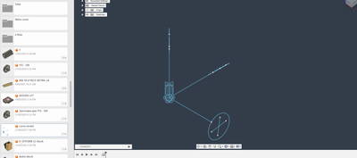

a.laasW8M6T
Hi
You can now as of the latest update just directly upload the step file in the data panel and it will import the curves as a sketch

kandennti
@a.laasW8M6T -san.
Thanks for the info.
I have tried it and the curves are imported even when open.
I tried Iges,Step,CATPart.
@atdemo2019 -san.
I don't think that add-in is necessary because they are imported when opened normally.
