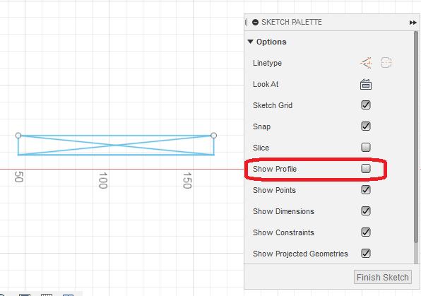

In any case, even with this simple a data set, the imported sketch is still not recognized as a closed profile:
Hopefully, there is a fix for this. Thanks in advance!

kandennti
Hi @Anonymous.
I have tested with the attached file.
If you go into Edit Sketch after execution and check "Show Profile", will it not be recognized as a profile?
The add-in is running with this unchecked to speed up the process.
If you are allowed to modify it, you can add the following line to end up with it checked.
class MyCommandExecuteHandler(adsk.core.CommandEventHandler):
    def __init__(self):
        super().__init__()
    def notify(self, args):
        eventArgs = adsk.core.CommandEventArgs.cast(args)
                # Done creating sketch entities
                theSketch.isComputeDeferred = False
                theSketch.areProfilesShown = True # <-Here
                # Request to create pipes and were any skecth lines added?
                if cmdCreatePipes and len(new_sketch_lines) > 0:
Message 15 of 18
hanskellner
Hi@kandennti -
Yes!  That was the issue.  With that disabled, the app wasn't creating the closed profiles.  Thanks for pointing that out.
I also found an issue with closing and connecting the start point and last point of a set of lines.
The fixes are now posted in the GitHub repo:
https://github.com/hanskellner/Fusion360ImportCSVPoints
Either grab the archive and copy over your existing files.  Or grab the Python file and replace the one in your installation folder:
https://github.com/hanskellner/Fusion360ImportCSVPoints/blob/master/ImportCSVPoints.py
Note, be sure to view and download the "raw" version of the Python file.
Hans
