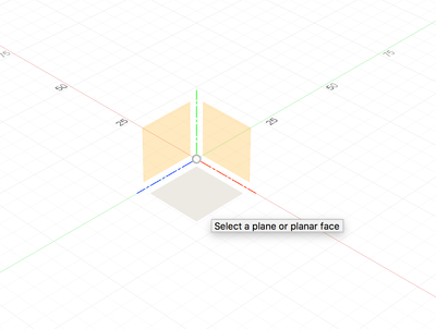

1. sketch Name have to named  contained plane name.
For example
스크린샷 2018-11-02 오후 1.27.34.png2. empty Sketch we don't need  fusion360 doesn't need to make
3. It has to be clearly recognized which sketch I'm sketching in sketch mode.
4. I want to off Auto Constrain Mode
Leave Message like under image.

I just went through your requirements for Sketch. Well You can do achieve some of them through API but not all.
1. You can create a new command which will create a sketch on the input planar entity and you can named it as per your choice.
2. By adding a new command for sketch creation then I think you can avoid working with Fusion Sketch command
3. Browser in Fusion design is not exposed through API so you can not customise it. Fusion is already marking the active sketch with a red-dart to show that it is current active sketch.
4. There is API on Sketch to hide the constraints
5. Again Fusion API does not allow to add new shortcut key customization
