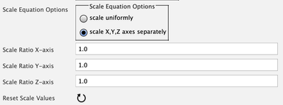

3) Is there a way to have the user control scaling via a GUI (i.e. similar to the actual Scale Feature pulling on 3 different axes) that just changes xScale, yScale, zScale ?
4) And if so, is there a way that updates the 3DMatrix Transform (e.g. in a triad)?  (If not, it's okay, I can create it directly).

The problem is:  I can't get "scaling" to work properly.  There ought to be a way to just get a simple X,Y,Z scaling to show up (i.e. arrows), as suggested by the API.
However, I haven't found any particular combination of visibility settings that show just regular X,Y,Z scaling with arrows in the GUI.
Moreover, the scaling that does show up (planar scaling?) doesn't change the transformation array.... seems broken.
I'm just looking to replicate the Scale function (Design->Modify->Scale) from Fusion 360 as part of my add-in.

goutam_reddy
Thanks for responding..
I decided to just program the scaling features manually, and not use a Triad for the scaling operation
(I couldn't get them to work....  i.e. just show the X,Y,Z scaling with arrows and updates to the transform (3DMatrix)).
As a future feature request, it would be great to be able to just implement scaling as done in the actual Fusion 360 program.
I started looking at calling Fusion 360 Commands from the api as "text commands", but it looks like that methodology "has been deprecated"....  so not sure if it worth learning how to do it if it will be stripped out.
Anyway- thanks for looking at the problem and reproducing some of the same weird behaviors.
