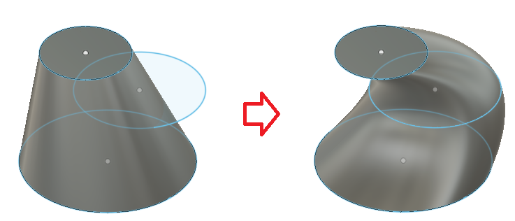

Hi @bjoern79de .
Using the attached file, I was able to process it like an image.
This is the source code.

        # get loft
        loft = root.features.loftFeatures.item(0)
        sects :adsk.fusion.LoftSections = loft.loftSections
        # get insert profile
        prof :adsk.fusion.Profile = root.sketches.item(2).profiles.item(0)
        # backup markerPosition
        tlPos :int = des.timeline.markerPosition
        # change timeline before loft
        des.timeline.markerPosition = loft.timelineObject.index
        # get the last LoftSection
        endSect :adsk.fusion.LoftSection = sects.item(sects.count - 1)
        # backup the last entity
        endEnt = endSect.entity
        # change the last LoftSection entity
        # LoftSection.entity was a read/write property
        # https://help.autodesk.com/view/fusion360/ENU/?guid=GUID-E0CE293E-9ED4-4E00-A5E6-32695A0F0A40
        endSect.entity = prof
        # add last entity backed up
        sects.add(endEnt)
        # Restore timeline
        des.timeline.markerPosition = tlPos
