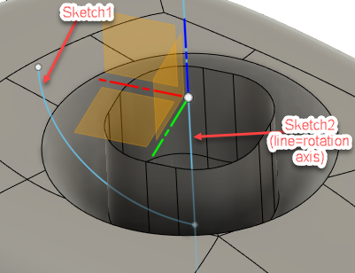

I have a sketch1 with a simply profile (only an arc). This ist my profile for the surface.
And a sketch2 with a line (this is the rotation axis).
How can I create a rotation surface form the sketch1 (my Arc) around the sketch2 (the rotation line) ?

Try something like this:
ui  = app.userInterface
doc = app.activeDocument
rootComp = doc.design.rootComponent
sketches = rootComp.sketches
sketch1 = sketches.itemByName("Sketch1")
sketch2 = sketches.itemByName("Sketch2")
axis = sketch1.sketchCurves.sketchLines.item(0)
profile = rootComp.createOpenProfile(sketch2.sketchCurves.item(0), True)
revolves = rootComp.features.revolveFeatures
revInput = revolves.createInput(profile, axis, adsk.fusion.FeatureOperations.NewBodyFeatureOperation)
angle = adsk.core.ValueInput.createByReal(math.pi*2)
revInput.setAngleExtent(False, angle)
revInput.isSolid = False
ext = revolves.add(revInput)
Sketch 1 and 2 might be reversed in your situation.

Thank you very much. It works fine
