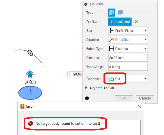

>3. There is alway "RuntimeError: 5 : No target entities were found to cut or intersect!"
You are probably right on the error message.
Create a new document in the GUI and create a profile in the sketch.
Then run the extrude command and set the operation to "Cut" and you will get the same error.
This error occurs when there is nothing to cut at all.
Since it is difficult to create a sketch that avoids duplicates, we have created a sample that randomly selects a face and creates a sketch point within the face.
