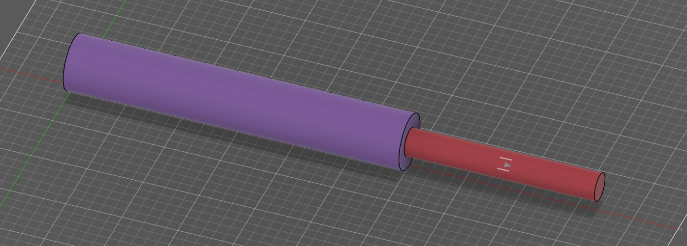

Hello community! I have a question relating to animating joint movement with a script. I want to write a script that will move my cylinder piston forward and backward. I know you can do this with a motion study, but motion study doesn't work for me. I want to connect a controller and control the piston manually. Does anybody have an idea how I can do this? Thanks.

Found the answer in this post https://modthemachine.typepad.com/my_weblog/2016/08/drive-robot-arm-in-fusion-update.html
Then I modified:
motion.rotationValue = motion.rotationValue + diffVal
And changed to:
motion.slideValue = motion.slideValue + diffVal
