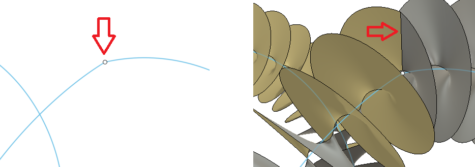

I don't know about these shapes, but since the Arcs are not smoothly connected, the resulting Surface is not smooth either.
Also, the first and last edges were not connected.
I think it was a problem with the twist angle calculation, but I couldn't figure out what was right.
