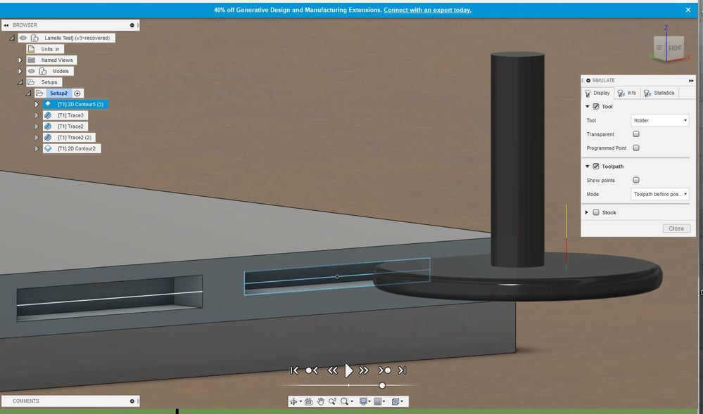

Good Morning/Afternoon everyone,
My shop is currently planning on purchasing a Lamello P-System groove cutter w/ a P-System arbor to machine slots on the edge parts.  I don't know if anyone out there is familiar, but I just made a test cutter from the 'Slot Mill' tool option and tried to pocket the edge of a part and was unsuccessful. If anyone out there is familiar with the Lamello CNC P-System, the biscuits aren't just pocketed out, they cutter actually plunges straight into the edge of the part, moves up and down slightly then centers itself and retracts out. Here is a reference from youtube - I am trying to achieve the same machining strategy just without an aggregate on the edge of the part - https://www.youtube.com/watch?time_continue=70&v=kfoQEZV9gV4&feature=emb_logo
Also attached is my Fusion file, a screenshot of my failed set-up and a PDF of the plan/section of the Lamello plastic biscuits.  Not sure how to go about something like this hopefully someone out there is knowledgeable in doing something like this

So I haven't made much progress but figured I'd share with you all anyway.  Also I know that groove cutter was drawn at the wrong Diameter, it is actually 100.4MM and 7MM thick
But the closest I got was trying to follow a sketch line with contour, which was not friendly at all and I still don't have a way of making it go up and down without retracting and going through something.
Am I missing something or is this possibly a programming limitation and I should be using AlphaCAM instead?
If there was a way to program it to follow points instead of bodies/sketches that may work? Not sure but I am running out of ideas
I've attached a screenshot of my progress and re-attached the updated file

 I think you would have to draw the entire toolpath, and use trace.  I can't think of any other method that would do this movement 😞

Using the pocket toolpath will work.
Is the cutter being used? going to be able to do the cut in one go or will it need meany step-downs.
You should model the cutouts to the shape they will be cut to and the tool as well.
It is definitely doable.

@daniel_lyall Here is the file with what it will basically look like more or less after it is cut.
Yes the cutter can cut it in one shot.  As far as 'modeling' the cutter exactly how it is in real life, I don't see any options in creating a tool that would allow me to do that, at least in the slot mill options. Also, my first post shows the plan/section of the biscuit - just for reference if that helps anybody.
See attached

I looked into this a while ago...developing a macro isn’t possible yet in fusion. As far as I know, the api doesn’t allow the necessary access to the cam side to directly manipulate the g-code output. Depending on your machine/aggregate capabilities you may be able to use the end mill style cutter from lamello, it’s much more fusion friendly to program vs the arbour style.

Ok here is a middle-of-the-night attempt at a workflow friendly clamex toolpath solution. I made a plug/tool component to create machinable geometry without the need for a 3d sketch. Note it does add 0.1mm to the width of the biscuit shape but that shouldn't effect the clamex performance. It will need some massaging before its machine ready but its a start.
Message 18 of 31
ryan
*Note on the above file...the "zig-zag" in the middle of the biscuit is so narrow I may be overlooked if the tolerance value for the toolpath is set to high. It seems to work best for me at 0.00001" the setting in the file I uploaded was 0.0004" and it was being a little buggy as I was playing around with it after. As I said its a start, I'd love to see someone get this thing working reliably. It would be a nice addition for us wood guys.

Just write the Gcode it is a lot easier.
O32123
G90 G94 G17 G69
G21
G53 G0 Z0.
(Adaptive1)
T1 M6
S7640 M3
G54
M8
G0 X100 Y100
G43 Z20 H1
G0 Z10
G0 G90 Z0
G91 Z-80
G01 Y150 F300
Z-10
Z20
Z-10
G0 Y-150 F300
G0 Z80 F300
M5
M9
G90 G53 Z0
G90 G53 X0 Y0
M30

100% the gcode is so simple. I just wish they would allow api access to position this kind of code within the model parametrically. If I had to hand code a couple hundred of these things in a project on mitered corners and all it would be a no go. +1 for api access to cam
