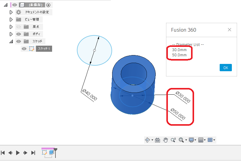

Can anybody help?
Is it possible, using a Python script, to extract the diameters of two circles in a sketch?
For example, If I create a hollow cylinder consisting of two circles extruded to a particular length, can I show the circle diameters in a message box?
Many thanks in advance!
Darren
559 Views
kandennti
Hi @isocam .
I took up the challenge.
Select a Feature.

isocam
Many thanks!!!
Is it possible to automatically always use Sketch1 rather than manually selecting the part?
Kind Regards
Darren
kandennti
@isocam .
If there are multiple extrusions, can you determine which profile is meant?
You need to provide more specific examples, images, files, etc. I can't make a decision based on words alone.
